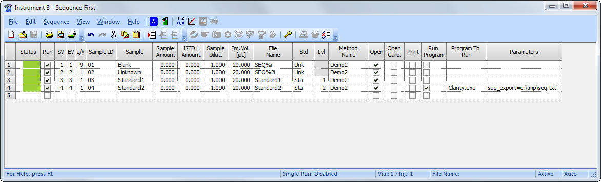

To export a sequence, please use File - Export... menu from the Sequence window. You can alternatively you can automate the export of the sequence by using command line parameter on the last row of the sequence (as shown on the following picture), the command line parameters available are described in the Reference manual, chapter 10.2. In the below picture the sequence table (sample list) would be exported after the last sample is measured, into the C:/tmp/seq.txt folder/file: Similar automated settings can be done for other exports as well.
