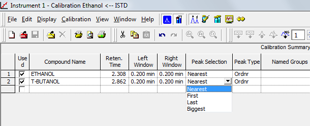

Dear Stuart,
please note the setting for selection of peaks in the time windows is already present in Clarity: The Peak Selection column is hidden by default, but can be displayed by using the Setup Columns... command from the Compound Table context menu in the Calibration window. I have done some testing today and the setting is not as straightforward as I would expect, so I have started a new issue (ISS59669), but it works.
As for the rest of the suggestion, would you be interested in viewing such intervals in Chromatogram window or in the Calibration window (or both)? The introduction of the feature might be more simple for the Calibration window, but part of the usefulness (e.g. seeing right away why the peak in the chromatogram of the sample is not identified/quantified) would not be that straightforward.

If it were possible, I would like to be able to apply the time windows (maybe displayed like error bars sideways) to the chromatogram window, so that if retention times change, it becomes obvious if the peaks are falling out of their prescribed time windows. But the major issue is to show if time windows overlap.
I was pleased to see that it is possible to specify how to deal with multiple peaks in the same time window. I didn't know that was now available, probably because it is so well secreted away, but that is a good addition to Clarity.
