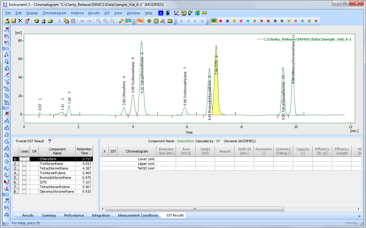

On a chromatogram of such High Control standard, create a SST method in the Chromatogram window using the
  • SST - SST Result (to display the SST tab)
  • SST - New (to create a new SST method)
  • SST - Update from Calib (to load the list of peaks from a calibration file)
the screen will look similar to this:

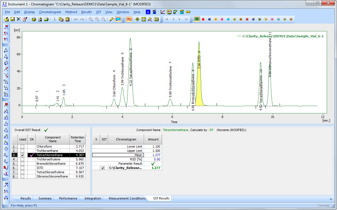

As a second step, fill in the necessary parameters for the control. Let us say my Tetrachlormethane peak is the one used for High Control, Expected Amount is 1.2, lower limit is 1.1, upper limit 1.3.
  • Select the checkbox of the Tetrachlormethane in the table on the left
  • Double-click the Amount Column in the table on the right to activate it
  • Set the 1.1 value in the Lower Limit cell of the column, 1.3 into the Upper Limit cell.
  • Right-click the table and select the SubParameters item. On it, switch to the Each Individual Value item and uncheck the %RSD Limit item (as you do not need it)
  • You may hide the inactive rows and columns by using the SST - Show All Columns and SST - Show All Rows items in the menu
You will see similar result now:

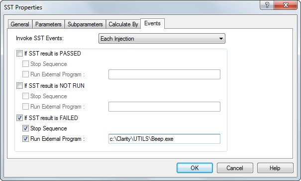

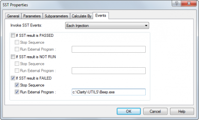

The result of the check is displayed by the green tick mark or red cross. You can validate several different parameters at the same time this way. Now let us set up the behavior for failing the test:
  • Use the SST - Events command to open the dialog again.
  • Set the tab as on next picture:
You can trigger any external program you want, set different events on failed check or passed check etc. Save the created method by using the SST - Save item (I used HighControl.sst file name). You can create the low control SST method in the same manner.

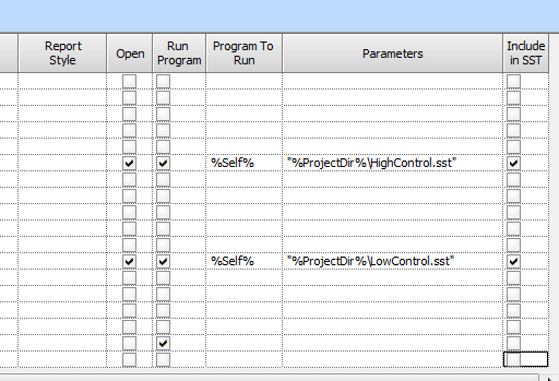

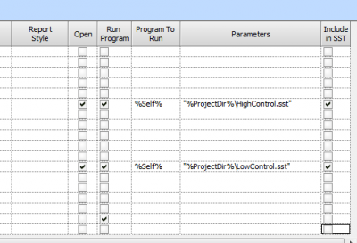

To set up run to be checked by the SST method, set the sequence accordingly:
  • Right-click the sequence table and select the Setup Columns item
  • Set the columns Open, Run Program, Program to Run, Parameters and Include in SST as visible (should be on the right side list)
  • set the columns for the rows with High Control and Low Control samples as shown on the next picture:
This will force Clarity to open the correct SST method for the row and perform the check. The check results can be moreover printed, the SST prints are set on the Report Setup - SST tab.
