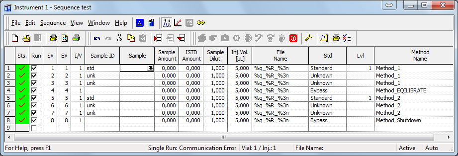

Dear Steven,
for this purpose I will suggest to create a specific method and run it in the Sequence between the two series of samples to equilibrate the system for the changed conditions. You could use the Bypass sample type to perform the run without actually injecting a sample. (On samplers not supporting this feature, use just injection of the solvent or blank).
The same approach by using a dedicated method could be used to shutdown the system after the sequence is finished
Please let us know, if this is a viable solution
