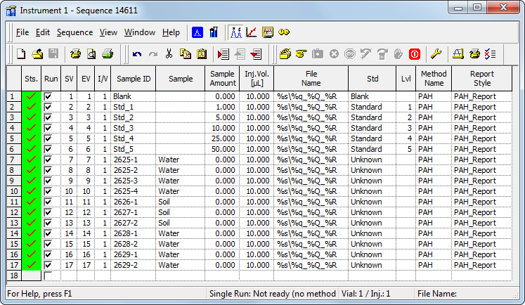

this feature has been implemented from Clarity version 4.0. In both Sequence window and Single Analysis dialog it is now possible to define the name of the file including the subdirectory - use the \ sign in the name of the file.
It is possible to use the standard Clarity variables in the name of the subdirectory - the file name could look for example like this: In the given example, %s\%q_%Q_%R is used for creating the file name, which means a subdirectory with the sequence name (%s) will be created in the working directory, inside of which the files with a name of SampleID_Sample_Date-and-Time format will be created.
If the folder is not present at the moment when the acquisition is run, it will be created automatically (you might be prompted to confirm the folder creation). If the subfolder is already present, the file will be created in it.
