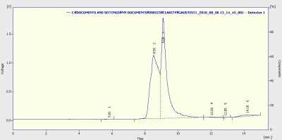

Hello,
I had the typical chromatogram sent by the user (see the attached file). The sample is low Mw synthesized compound. Two peaks are separated incompletely. The user would like to apply Gaussian fitting to it, and make the simple two peaks. He is using Origin software with Clarity. http://www.originlab.com/index.aspx?go= ... akAnalysis

Dear Miyako,
the chromatogram you have showed us seems more like there are at least four unresolved peaks - the first "major" one has strange lumps both before and after its maximum. I'm afraid that the deconvolution procedure could create any result you wish from such peak cluster, based on the conditions you set to the procedure - it would just be a guessing from the crystal ball. Moreover, peaks generated from GPC are usually far from Gaussian shape, so I'm not sure any deconvolution would help in this type of analysis.
Please, could you send us the *.prm file or two with the mentioned peak cluster to support@dataapex.com for some testing?

Dear Daniel,
Thank you for your reply.
I was conscious of several inflection point on the first peak. But this peak is one compound. In this case, ELSD is used as a detector, so peak shape is sometimes distorted. Actually, the peak is one peak.
I think the user would like to take Gaussian peaks simply created corresponding to "Local maximum" of chromatographic curve recognized as sample peaks.
I will send the prm file to you by e-mail.
