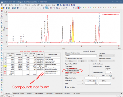

I may not understand the question. mount% is calculated every time, even when not all peaks are in the chromatogram. Please see following screenshot:
Calibration contains additional peaks which are not present in the sample, yet the Amount% column is still calculated. It is just not visible for the peaks not found (result there would obviously be 0%).
Display of the peaks not found in the sample but present in the calibration can be switched on by selecting the All Peaks in Calibration display option.
