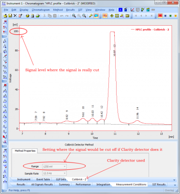

Dear Federico,
as discussed over email, the signal is probably cut off by the detector itself. Please take a look at the following picture: I was curious which detector you are using - this can be seen from the measured chromatogram. As you use A/D Converter, the signal can be cut off at two sources - either at the instrument itself, or by the A/D Converter. In the A/D converter settings you can see that the range is set to 1250 mV, so if the A/D converter does the trimming, the signal will be cut off at that value. However, your signal is cut off at approximately 100 mV, so it comes already cut off into Colibrick. You can also zoom in to the cut-off portion of the signal, on sufficiently enlarged zoom on y axis you will see that the top of the cut-off peak is not completely flat, but still rises somewhat. If A/D converter cuts the signal off, you would see completely flat part of the signal
