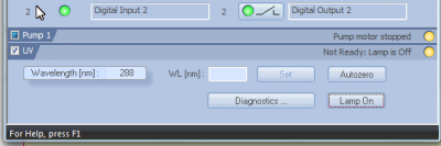

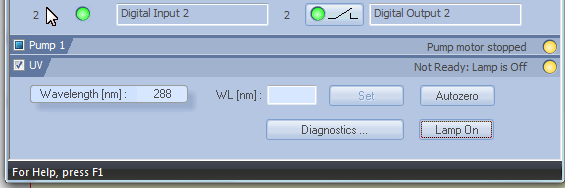

Re: Knauer Detector Diagnostic
Hello Daniel,
Just FYI
Regarding the Knauer detector device
I attached a screen shot.
Regards,
Mike
Just FYI
The device monitor only has a diagnostic button, there is no info button. Clicking on the diagnostic button does not open a new window or display any information.lamp hours should be available through Info... button, while the reference wavelength settings through Diagnostics... button
Regards,
Mike
Hi Mike,
I admit I have tested the behavior on Knauer detectors I have available (S2600, PDA-1) which are different from your model. I was only able to test the behavior with BlueShadow 10D detector in DEMO mode (simulation) which does not allow entry into the Diagnostic screen. Anyway, Knauer got all the information and promised to look into the matter.
Best Regards,
Daniel
Best Regards,
Daniel
