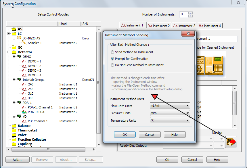

The Method sending options (in System Configuration, large icon lower right corner) – the option should be (default) Confirm method sending or Do not send method for this to work. In case the “Send method” is selected, the currently opened method on Instrument window will be applied after finishing the sequence, which may turn the system back on.
Fig. 1
Fig. 1

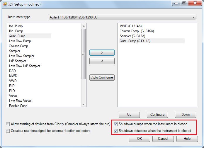

The behavior of the Agilent ICF control at shutdown is governed by the options set in the ICF Setup
The shutdown from Event table performs the same operations as the Instrument window closing, you need to check the Shutdown pumps/detectors when the instrument is closed.
Fig. 2
Fig. 2

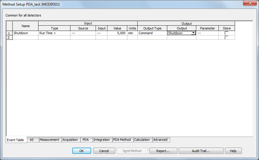

The shutdown method to be run as last in sequence need to have the respective command in Event table at suitable time:
Fig.3
Fig.3
