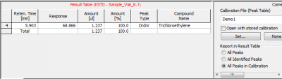

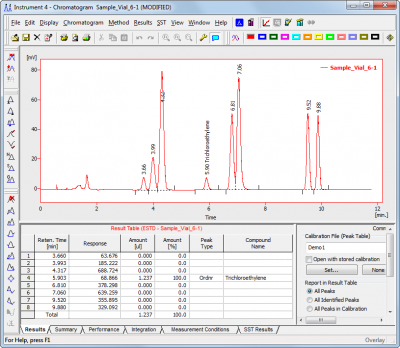

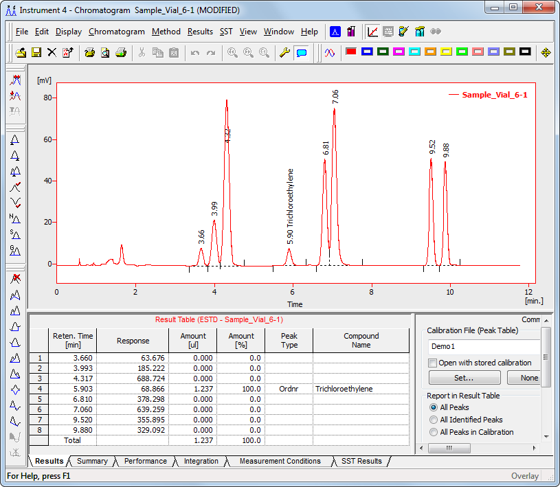

I understand now.
Actually, for this you have two options of display - selecting the one you want is up to your choice.
Suppose I create a calibration with just one calibrated peak and the rest of them are uncalibrated. When I return to Chromatogram window, the result table would like similar to this: Please note the file has multiple peaks, just one of them is in the calibration and all others are displayed without the name and amounts.
The other option is to switch the display of the result table only for peaks present in the calibration - you can switch the radio button in the pane right of the result table to see this result: The printed reports will look exactly like on the screen, nothing changes with the graph - just the result table is influenced.
I understand now.
