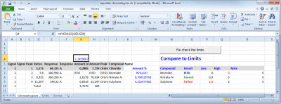

automatically export the result table after the analysis (by setting the postrun settings)
open the exported file in MS Excel,
format it and add custom calculations (formulas and a table of limits loaded from the other sheet (limits)
Detailed description is included in the ZIP file.
Can you have a look at it and let me know if it works for you?
Eventually can you send me a description or a sample of the outputs that your customers want to have in Excel?
Actually everybody who has some excel sheets and want to use them with Clarity, please send them in, it will help us to focus the planned excel support to cover these requirements.
Screenshot of the Excel sheet created using the macro
