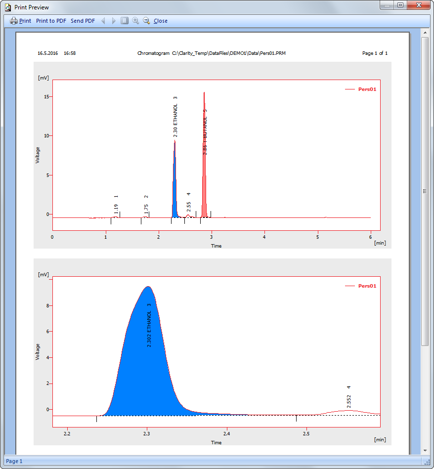

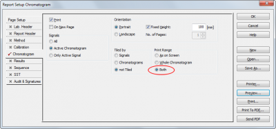

Dear Sir,
the feature is available in Clarity. Please open your Report Setup dialog, switch to the Chromatogram tab and set the Print Range setting to Both: In the created report, there will be two graphs - first showing the whole chromatogram, second showing the actual zoom in the Chromatogram window: It is not possible to set the display of the highest peak to be printed automatically this way zoomed, you need to perform the desired zoom manually. The highest peak is very often not the compound of interest. Also, the "inset" zoomed peak might clog another area of interest in the chromatogram, so we prefer to print the graphs tiled.
