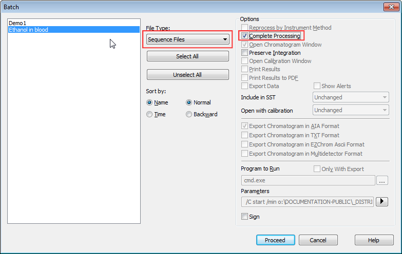

However you can fill the amounts in the already measured chromatograms.
In the Instrument window use the Analysis / Batch command to open the Batch dialog.
Switch the File Type to Seuence Files, select your sequence and check the Complete processing checkbox.
It will reprocess the whole sequence according to the sequence table, including the "Print" column.

Yes it is possible to reprocess the whole sequence and get the reports.4. As I can do a reprocessing of data in the same way as the sequence was acquired, and get the reports
